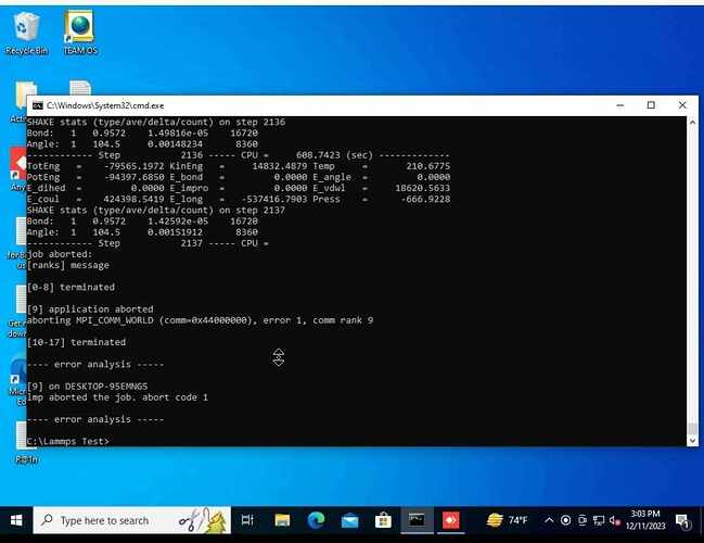

  2. As I am running using the command “mpiexec -np 18 lmp -in NaCl.in” , I am constantly getting following error as described in the image during energy minimization step.
I am trying to simulate crumpled graphene electrode with NaCl electrolyte using constant charge method. I am running lammps ms-mpi executable 2 August 2023 version. I am attaching my data file and input file for reference.

I am constantly getting that abort error around 2000-3000 steps using the same input script and structure as mentioned above. I am attaching a log file below of the run I am getting this error.

LAMMPS rarely/never aborts without an error message, but sometimes it doesn’t get flushed out to the screen. You need to figure out what that error message is, if LAMMPS is crashing. Does the input run correctly on 1 MPI rank?
You can try to get a “core” file and then read it with the gdb debugger tool. You may next to set ulimit -c unlimited if you are on Linux.

  • thermo_modify lost ignore and thermo_modify lost/bond ignore hide errors and must not be used for a system like yours. With them you would probably have seen a ERROR: Lost atoms: original 31980 current 31976 or similar.
The system you simulate has serious problems. Your temperature rises to extreme levels (like over 10000K) which is an indication of a very bad starting structure or a very bad force field or both.
You cannot just ignore this. Running a molecular system at such high temperature will lead to all kinds of irreversible changes and render the entire simulation bogus.
I am convinced the reason you don’t get an error message is due to your suppression of the lost atoms or bonds errors. Suppressing a symptom does not solve a problem. At some point LAMMPS notices bogus data and just crashes because the checks that your data has become bogus are disabled.
The best process to figure out how to set up and equilibrate such a system properly is to set up small calculations of the individual subsystems and figure out how to setup such systems properly and run a stable simulation for that subsystem. That is much faster and you reduce concurrent sources of errors. I think this starts by trying to figure out where the high potential energy comes from and how it can be reduced before the first minimization. If that doesn’t work, you will have to do a sequence where you alternate multiple times between several 1000 steps of minimization and short MD runs that stop before temperature gets beyond 300K. Then quench again and repeat until the system can run without huge amounts of kinetic energy being generated. You may also need to reduce the timestep during that period.
