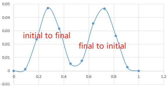

I did a neb calculation to obtain the Peierls barrier for screw dislocaiton using ADP potential. But the results show double saddles, as shown below. The two saddles correspond to the two paths: initial position->final position and final position → initial position. I’m confused why it has the second path: final->initial. I also tried to use the relaxing model for both initial and final structures, as well as changing spring and tolerances, but the results are the same.
Does anyone has the same problem? Could you please tell me the reasone? Thanks very much.

It looks like your neb algorithm has found a metastable intermediate state. Maybe your screw dislocation is rotating? Have you analyzed the molecular configuration to understand what is happening?

The initial and final states are the neighbor easy cores of screw dislocation.
The configuration of dislcoation cores seems Okay for the first path (from initial position to final position). Please have a look on the animation and command file. The dislocation goes to final position from initial position and then return, which correspond to the two saddles in above figure.
