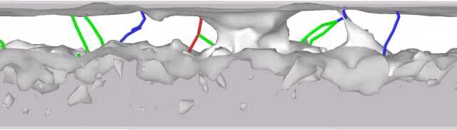

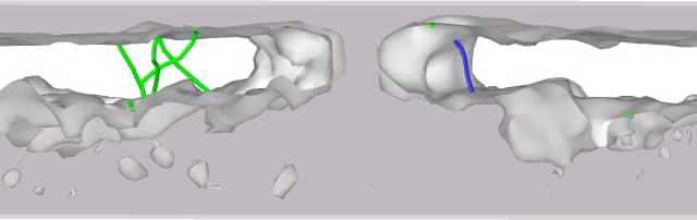

I am performing nanoindentation simulation on Ni-Al FGM using LAMMPS with MEAM potential. Pure Ni and Al substrate gives smooth indentation morphology, but the FGM structure consistently shows severe surface tearing, rough mesh morphology during indentation. Force displacement graph is okay for all structures on current condition, But penetration snap at higher displacement shows teared mesh surface which is very abnormal.

However, FGM still develops:
  • jagged penetration surface
  • mesh tearing
Pure Ni and Al under same conditions behaves normally.

Some snap of dump file from OVITO:
Any suggestions regarding stable indentation setup or validated Ni-Al potentials would be highly appreciated.
