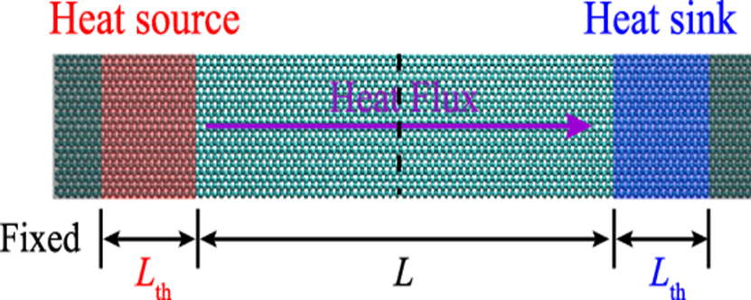

I am reading the example file (lammps/examples/KAPPA/in.langevin) in the github.
The image above shows a typical NEMD schematic.
Two Langevin thermostats, each at a different temperature, are applied to specific regions to create a temperature gradient.
