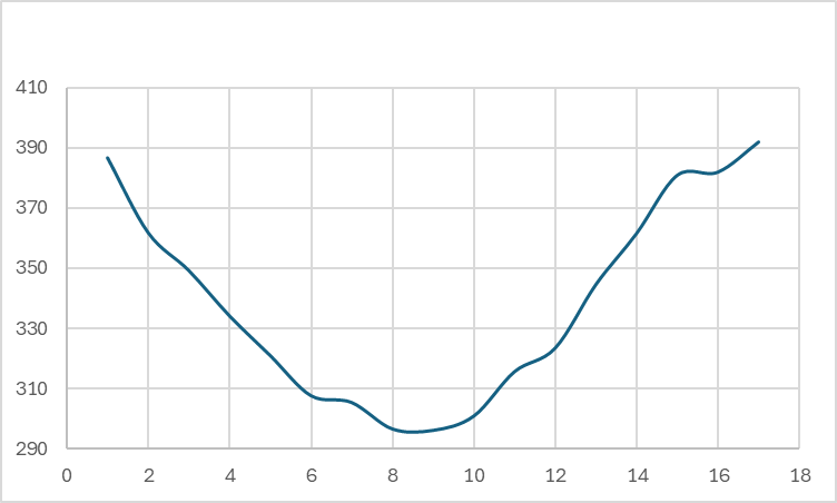

For the single crystal in x direction, I get a pretty linear profile shown below.

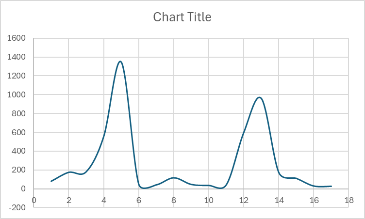

However, as soon as I put 2 grain boundaries at the 1/4 length and 3/4 length (to maintain symmetry), the same exact input file gives a very unexpected temperature profile with temperature spikes at the location of grain boundaries as shown below
May I ask if I am doing something wrong here? I tried different grain boundary types like sigma 5 and sigma 41 and both are showing similar behavior. Is there any suggestions/corrections I can try please?

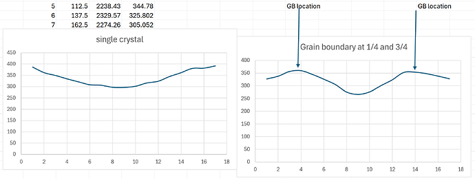

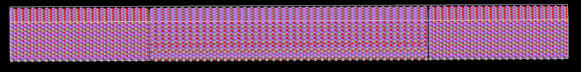

  1. Construction of structure file- I made 3 crystals (length along x axis) and attached them along x axis. Crystal 1 is 104 Angstrom X 31 A X 31 A, crystal 2 is 208 A X 31 A X 31 A but is rotated by just 1 degree around the x axis using atomsk, crystal 3 is same size as crystal 1 with dimensions 104 Angstrom X 31 A X 31 A. All 3 crystals are individually charge neutral with no missing atoms or bonds.
All 3 crystals are then attached together (attached file is called combine1.6) and I intentionally put a 1.6 Angstrom gap in between crystals as shown below in the image. I put the gap so that atoms dont overlap with each other. Most bond lengths in LiAlO2 are 1.6 A or larger so I put a gap of 1.6 A.
Then I minimize and relax the structure in NVT ensemble. After that I do the NEMD by supplying heat at left and right ends and extracting heat from the center. The location of the grain boundary still shows temperature spike as shown in the right plot below. Previously without the 1.6 angstrom gap, I was observing temperature spikes of up to 1000 degrees which has currently come down to just 50 degree but is still hotter than the heat source bin.
The single crystal gives a nice profile matching with the experimental thermal conductivity.

Currently I am doing this:
Would you recommend any other method please?

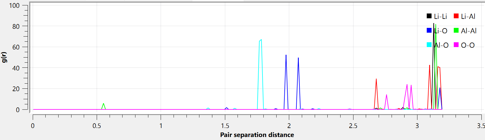

Apparently your input structure has some atoms abnormally close to each other:
