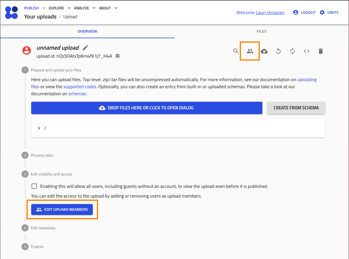

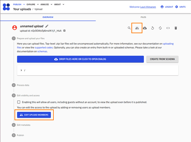

Hi @Ousseynou!
I think you are looking for the groups feature of NOMAD. This feature is not so visible from the interface or from our docs, so it is understandable that you may have missed it - we have to improve on this situation.
The basic idea is:

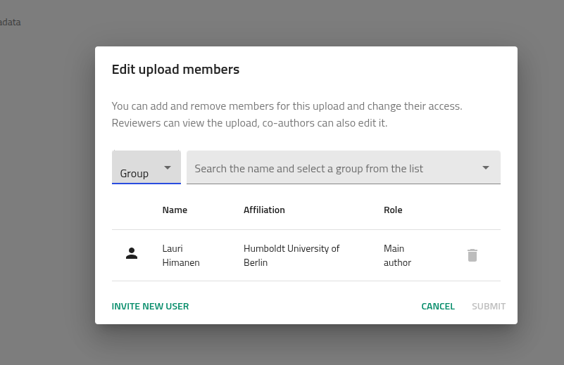

  • You can create user groups with a name and a list of users that belong to them
  • An upload can be shared with a group: groups can either have read-only access or read-write access.
Groups can at the moment only be created through the API, as documented here: Use the API - Documentation. Once you have a group, you can add the group to an upload through the GUI, see screenshots below.
Do you think these groups will help you achieve your goal?
