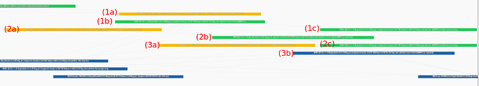

A related issue:
In this blurry workflow snippet
the following happens:
An initial Fireworks (1a)
runs LAMMPS until walltime expires on an HPC resource. It is then marked as “fizzled” with a suitable “lpad detect_lostruns --fizzle”, as described in the first post in this thread. A subsequent recovery Firework (1b)
with {“spec._allow_fizzled_parents”: true} recovers the necessary restart files, automatically appends a suitable restart run (2a)
with another subsequent recovery Fireworks (2b) as well as some post-processing Fireworks (1c)
This recovery loop then repeats (2c, 3a, 3b, …) until the LAMMPS run finishes successfully.
What happened in the above example is that due to the issue 2 described in the previous posts here, Fireworks 1a and 2a have been marked as “running” again after they were marked as “fizzled” with “detect_lostruns” and their “allow_fizzled_parents” children 1b and 2b started to run. The dangerous point here is that if another “lpad detect_lostruns --fizzle” is applied without carefully discriminating between the “generations” of Fireworks in the tree here, 1a will be marked as fizzled again, and all its children, grandchildren, etc. will lose the information on its current state and be marked as “wating” again, with expensive computations already finished (i.e. 2a), currently running (i.e. 3a) or queued on the HPC resource ‘dropping out’ of the workflow management framework, without simple means to recover these.
Here, a way to fizzle these lost runs 1a, 2a again properly without affecting the state of their children is necessary to keep the workflow information in the database coherent with what is actually present on the computing resources and file systems.
Johannes

A related issue:
Johannes

A related issue:
Johannes

On Tuesday, August 6, 2019 at 7:04:01 AM UTC-7, Johannes Hörmann wrote:
A related issue:
Johannes

A related issue:
Johannes

A related issue:
Johannes
