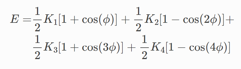

My question is: when EMC spits out a .params file for LAMMPS from its build with OPLS, it chooses the harmonic, harmonic, harmonic, multi/harmonic, and harmonic styles for bonds, angles, dihedrals, and impropers, respectively. The bonds and angles I get, these match the form of OPLS. But for the dihedrals and impropers, the form specified in OPLS is a four-term cosine series,
for both types. The multi/harmonic dihedral potential in LAMMPS is given by
