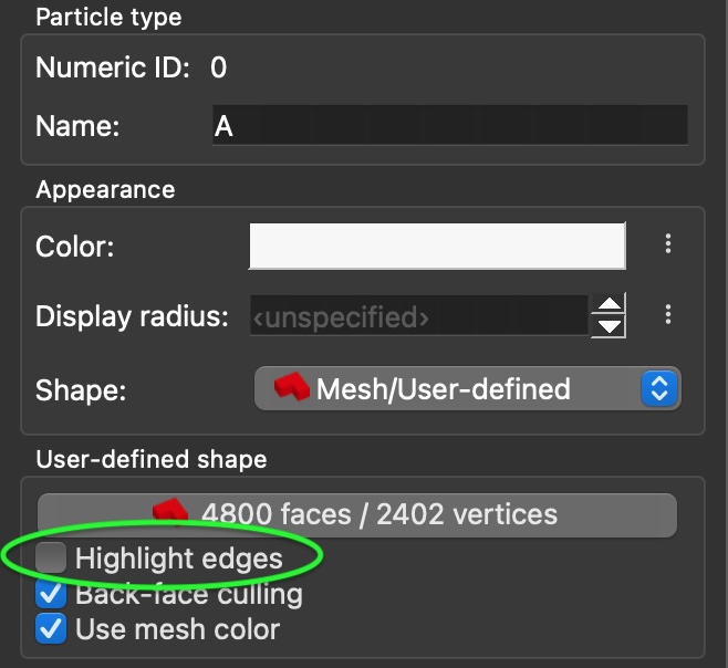

And a 4th suggestion:
Please make sure this option is turned OFF. The rendering of highlighted mesh edges can overwhelm the graphics card with an instanced mesh having so many faces.
