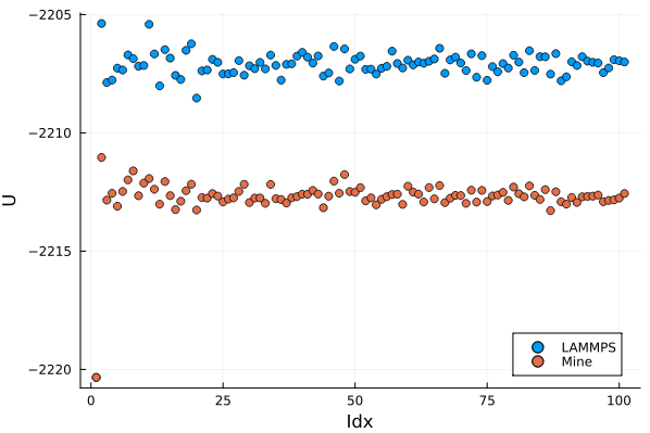

I coded up my own version of Stillinger-Weber silicon using the default parameters in LAMMPS. At equilibrium my code produces the exact same value as LAMMPS; however, once I include dynamics there is a noticeable gap between my implementation and LAMMPS. I am not asking for anyone to debug my code rather it would be nice if someone could offer ideas as to what might be different.
The one thing I noticed is the LAMMPS docs specify the 3 body term to loop over i, i !=j, k > j whereas the SW paper denotes this sum as i > j > k.
Here is the comparison, the x-axis is just an index into my array the actual spacing between points is 10ps.

I’m just comparing energies at the moment, I have no derived the force calculation yet.
Forces are what matters in MD. Energies can have arbitrary offsets.
I agree, but wouldn’t you expect the offset to be identical at all time points? Here the offset fluctuates from ~4.75-5.5 eV.
I’m not exactly doing MD right now just using LAMMPS to double check my work.
Then I suggest you check each component of the energy/force computation individually.

I used LAMMPS to run dyanmics and printed the xyz and the energies. Then I used the positions to calculate the potential with my own implementation. I guess I just mean that its different at everything besides equilibrium.
