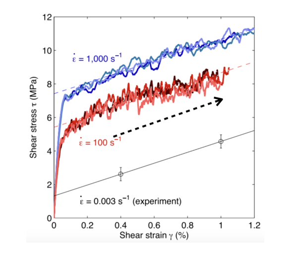

But I have seen papers in which material undergo strain hardening after plastic deformation in DD simulations as shown below:
