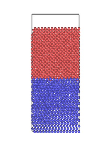

The simulation of pure iron-titanium metal connection, with iron on top and titanium below. The top and bottom three layers of atoms are fixed, the NVT ensemble relaxation is performed, and then compression is carried out using the fix move command. The compression is divided into two stages; the first stage is fast, and after compressing to a certain extent, the second stage of compression is performed at a slower speed. The current issue is why there is almost no diffusion during the compression process. Below are my code and simulation results.

The following are the results after running 500,000 steps, and it can be seen that the atoms have hardly diffused. What could be the reason?
