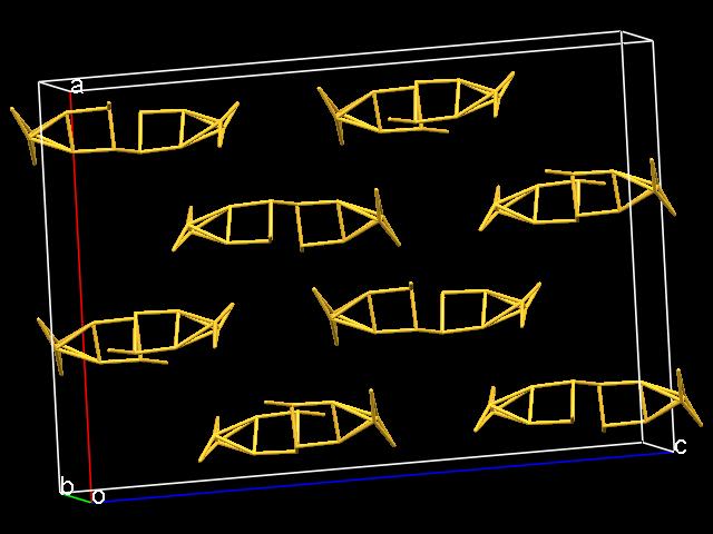

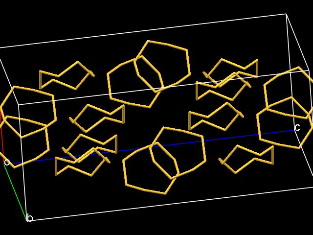

Unfortunate the final geometry is still incorrect. See following screenshots from Mercury:
FURHUF_GULP_6_3_3
It is far from the experimentaly determined structure (confirmed by my by geometry optimization in 3 different engines CASTEP (r2SCAn+MBD, Quantum Espresso(PBE+D3), ASE/MACE_OFF23L)
FURHUV_experimental
The CIF with incorrect geometry generated by GULP 6.3.3:

I talk abou pGN-FF generating for this specific structure in GULP a result wich have nothing to do with reality (see the short contact suplhurs). It is an exception from a few thausands of my test for witch pGN-FF give somehig giving sense with acceptable agreement with other methods. But this structure is a total outlier with final geometry converged to something not giving sense. There must be something specific (space group ?) why this structure does not work. I will try to recalc in P1.
The target of my work is to use GULP as pre-screening method for latge dataset experimental structures validation, before using more computationaly expensive methods.
If you’re referring to the initial structure, then you might want to try add “origin 2” after the space group for orthorhombic S8
Problem solved. We on our side detect the origin 2 setting from the CIF file, but we did not exported this to the GULP input. Adding
origin 2
gives correct output …
