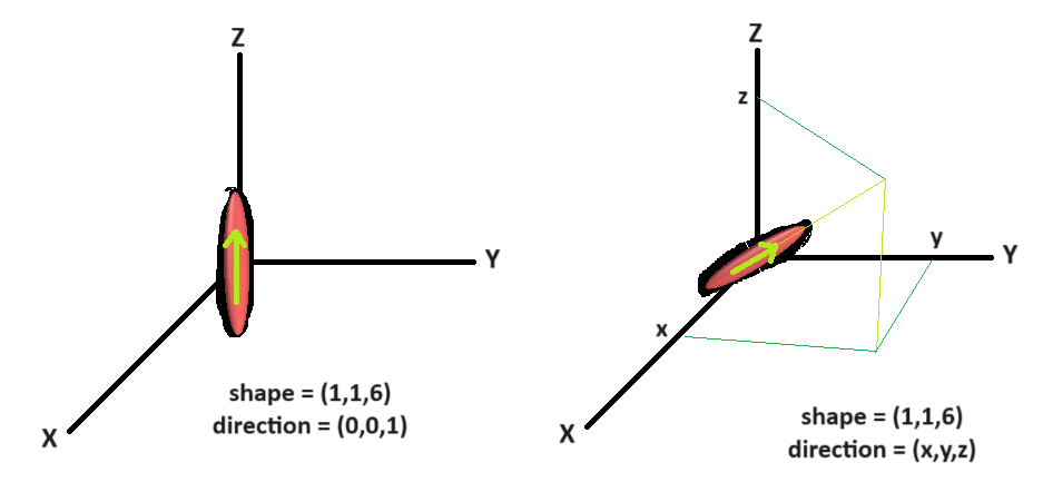

Dear all, I have created an ellipsoid with its shape (1,1,6) as shown. I would like to make its tip to point to the direction (x,y,z). I was wondering how to define quatw, i, j, k.
I try to figure out how quaternion work but still in confusion. I cannot find the expression of quaternion in LAMMPS manual also.
