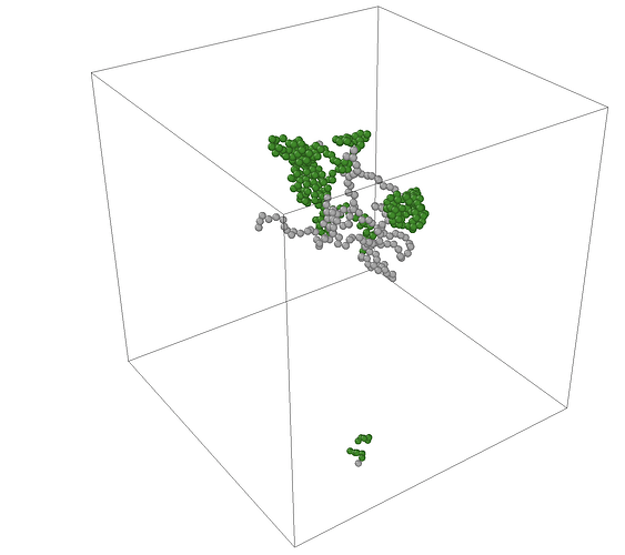

So I’ve been running different tests. Here I show a snapshot of the system with the rigid bodies in green and the flexible parts in gray:
The box is a 200^3 square as I stated above.

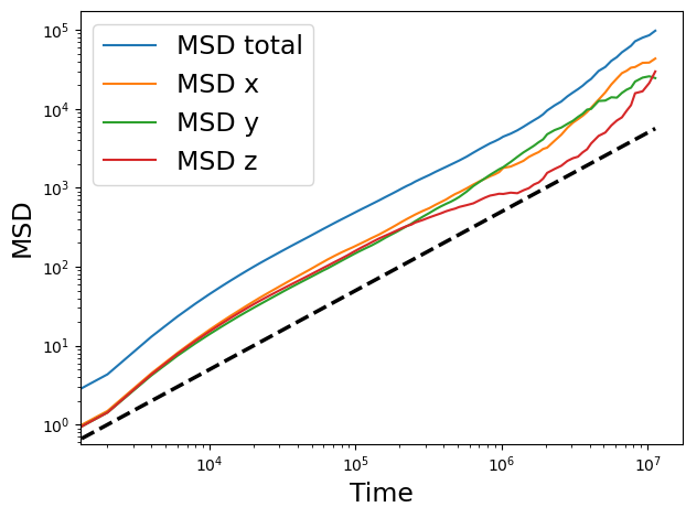

I have calculated the MSD of the polymer center of mass and got a fairly homogeneous result for the three components considering the noise at long times:
The black dashed line shows the diffusive regime.
