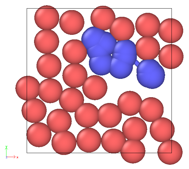

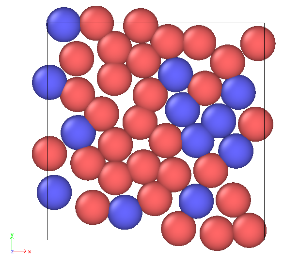

Prof. Kohlmeyer, you are absolutely right—I should have started with a simpler minimal example. Doing so has indeed helped me better identify the source of the issue. The problem seems to arise specifically when I define the bonds in the data file.
When bonds are included in the data file that LAMMPS reads via read_data, the bonded atoms appear to ignore pairwise interactions and overlap, even though the bond interactions themselves seem to function as expected. However, when I remove these bonds from the data file, the particles behave as anticipated, repelling each other in accordance with the pairwise lj/cut settings. I have attached two minimal inputs that illustrate these different behaviors. The problem is likely due to the way I write the data file, but I am still unsure what I am doing wrong. I also tried using different atom styles (such as angle) in the data file, but encountered the same issue.

This is the expected behavior for molecular force fields. It would otherwise make the parameterization of bonded interactions extremely difficult, since they need to be linked to the atom types of the participating atoms. If you read up on these so-called exclusions, you will learn those are usually applied to direct neighbors (1-2 neighbors), neighbors of neighbors (1-3 neighbors) and sometimes even one level more (1-4 neighbors). How those exclusions are applied is controlled in LAMMPS by the “special_bonds” command.
For bond style fene, you are usually required to use the corresponding special_bonds setting. Even for special_bonds fene, the 1-2 non-bonded interactions are excluded.

Thank you both for your guidance throughout this thread. The use of special_bonds lj 1 1 1 has indeed resolved my issue. Thank you for the time you spent helping me understand this.
