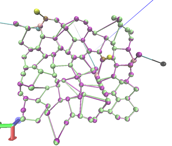

But when I run the simulation it crashes and when I visualize it the sp2 carbon atoms try to make 9 bonds per each atom.
crashes how? in what subroutine? is there an error message?
only in parallel or also running with only one process?
According to the manual extra special per atom = leave space for this many new special bonds per atom. So the number 9 that I use may be the cause of this. Can anyone please be kind enough to help or give some information on this?
adding 9 extra special atoms on top of what your non-drude topology requires sounds very unlikely.
something else must be wrong.
there is not enough information here to give more specific advice.

  1. When I try to run without the extra/special/per/atom command LAMMPS gives me an error asking to put extra/special/per/atom 9
on my machine it is 7. but either number is fine and not causing any problems.
  1. I got the error in the serial version. The error was “ERROR on proc 0: Out of range atoms - cannot compute PPPM (…/pppm.cpp:1936)”
if you change your input to use a (much) shorter time step (1fs is large even without drude oscillators) and print thermo data more frequent, you will see, that this error happens only after a while and that immediately after starting your pressure is huge and temperature is increasing massively, too. that is usually a sign of a bad topology and/or bad force field parameters.
if you also increase the frequency of trajectory output, you can see some atoms/molecules being highly accelerated. so you need to figure out, why that happens. typically, this is due to close contacts of bad force field parameters.
Dear Dr. Axel,
Thank you so much for the reply. Yes I saw a huge increase of temperature and pressure after some time and then it crashed. Then I visualized the trajectory and from that I saw that the sp2 C atoms are trying to make 9 bonds. Can you please be kind enough to ket me know that extra/special/per/atom wanting to be 9 is due to the data file or a fix or anything else that I am using?
Thank you.
Visal
Dear Dr. Axel,
9 bonds is nonsense. you are using a force field, where the number of bonds cannot change. this must be an artefact of the visualization tool that you are using, which is possibly computing bonds heuristically based on distances.
i’ve stated now MANY times, that using your extra/special/per/atom 9 setting is NOT responsible for this behavior. when i visualize the trajectory i see plenty indicators, that you have bad force field parameters or settings.
