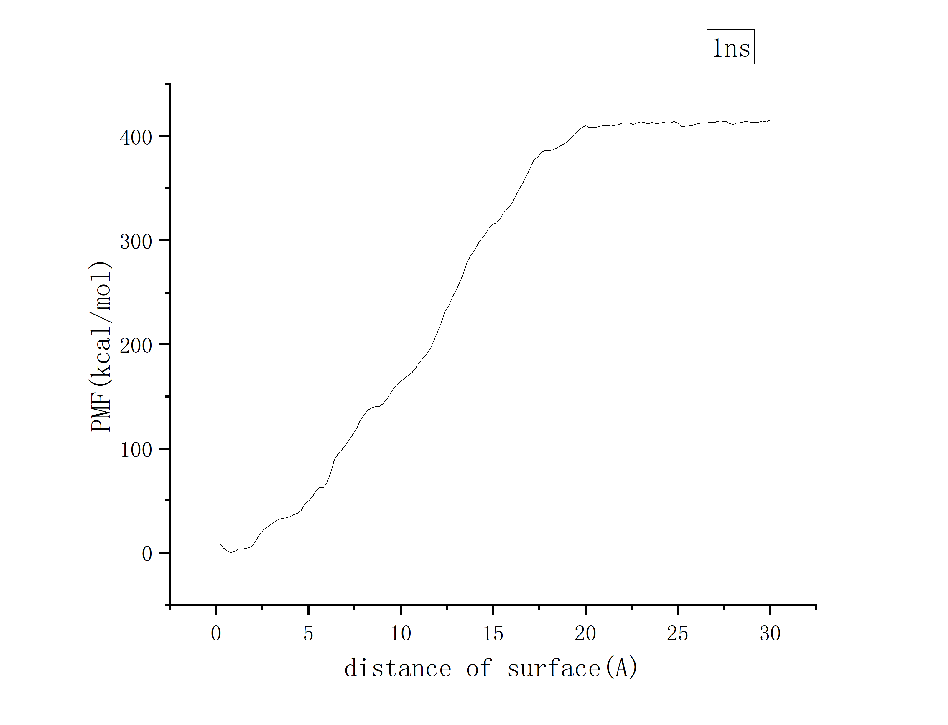

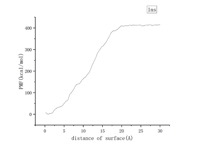

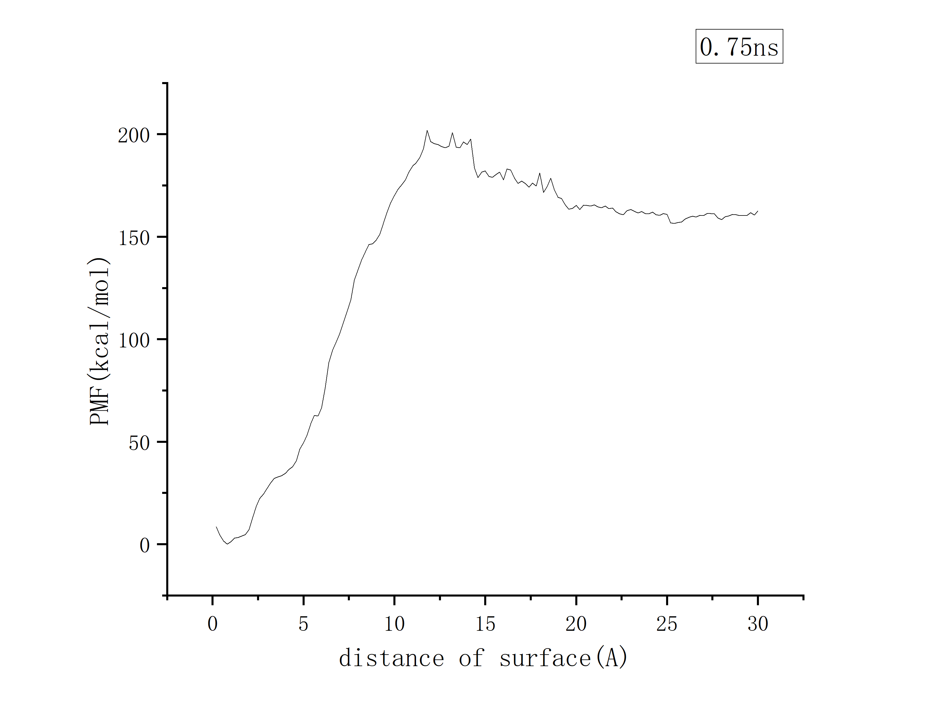

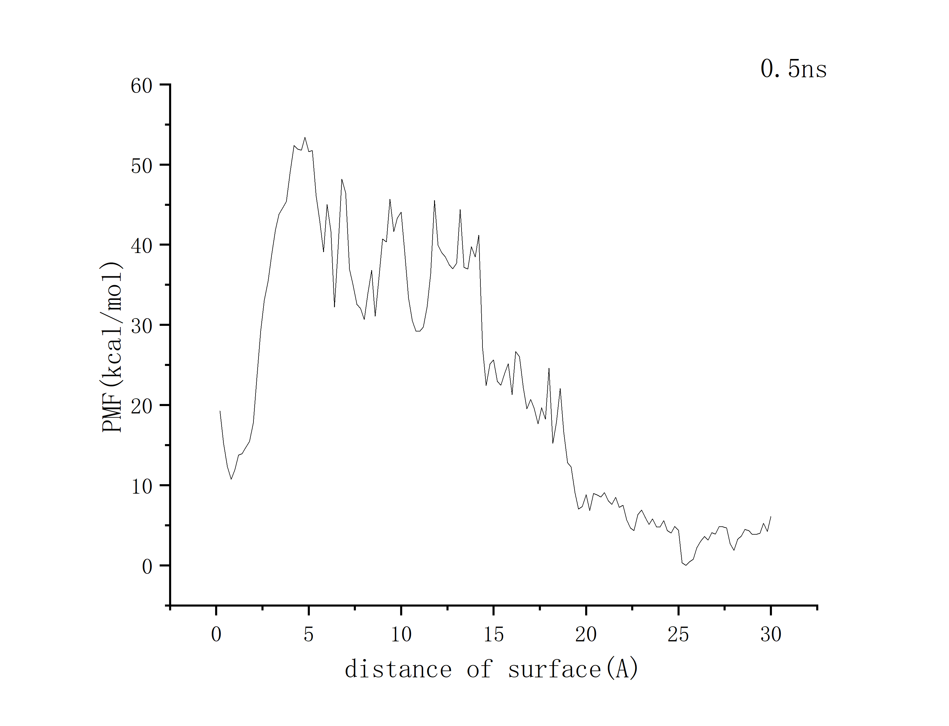

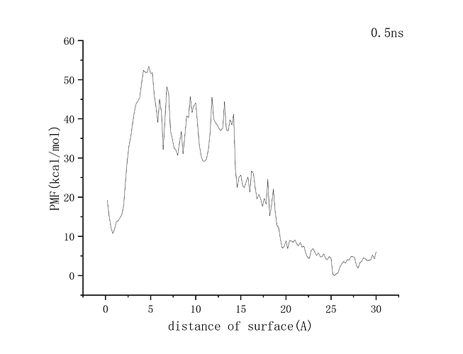

I am using LAMMPS’ Colvars module to calculate the free energy between two nanoparticles in a fluid as a function of distance, but I have obtained unacceptable results. I ran 0.5ns, 0.75ns, and 1ns under fix colvars and found significant changes in the shape and magnitude of the PMF curve. I think the change in the shape of the curve is the reason why my simulation did not converge due to insufficient running time. But I don’t think there should be such a big change in the PMF value, and I don’t know if it’s related to me not writing the colvars file correctly. I also want to know if there are any other methods to determine convergence besides periodically outputting PMF observations. The PMF curve and colvars file generated by running the output are shown below:
