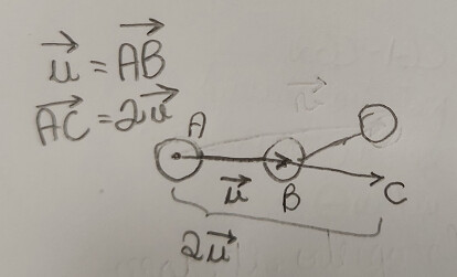

So, essencially I have some CO2 adsorption GCMC results from RASPA that I am trying to use as a starting point in my MD simulations. From the topics that I have seen in this forum, most likely my issue is with the starting PDB file that is given by RASPA, which doesn’t provide enough accuracy to ensure a linear CO2 molecule for fix rigid.
I have already tried to use fix viscous to drain energy from the system, as well as some other suggestions provided in this forum.
The reason why I am not using create_atoms is because I want to start from the GCMC results. There are other more complex systems with highly saturated binary mixtures that will make it really hard to introduce molecules without overlapping.
