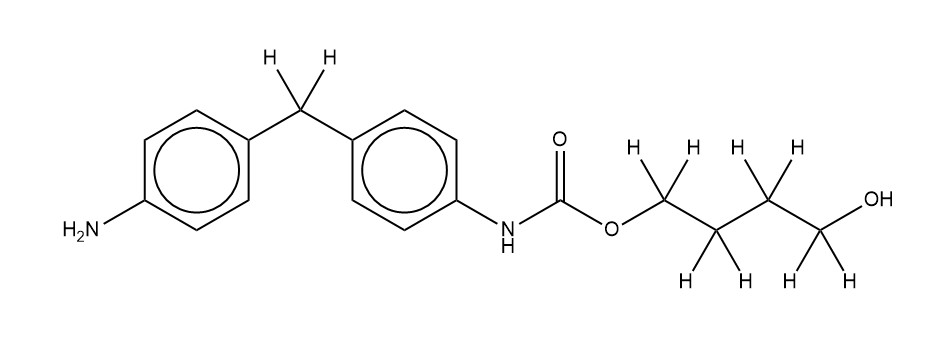

when I tried to build molecule like as below with PCFF, EMC gives tips :
Warning: increment pair {o_2, c-} set to zero.
Warning: increment pair {c-, na} set to zero.
Warning: no torsion coefficients found for {hc, c, o_2, c-}.
Warning: no torsion coefficients found for {c, c, o_2, c-}.
Missing force field parameters.
Program aborted.
smiles: [H]C([H])(O)C([H])([H])C([H])([H])C([H])([H])OC(=O)Nc2ccc(C([H])([H])c1ccc(N)cc1)cc2
How to solve this problem? thank you.
