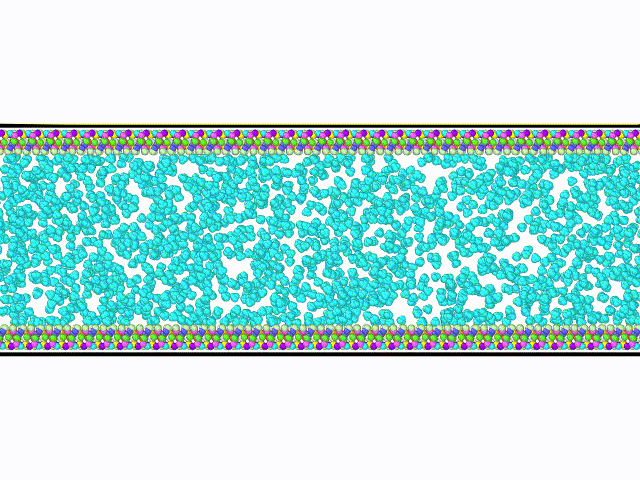

I am going to simulate methane flow within the kaolinite nanoslit. I fixed the bottom layer of kaolinite while applying force on the top layer to create a 10 MPa pore pressure. But I found only hydrogen atoms in the top layer move down during the simulation. Following is the command I used to fix the boundary, can anyone tell me how to make the top layer move as a whole. The version I used is LAMMPS (29 Sep 2021)

Hi all,
I found that if I use “fix rigid/nve” instead of “fix nve” to make top layer rigid, it can move as a whole, anyone has other methods for this?
