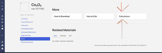

  6. The provenance collection is up to date. You can retrieve tasks which were used to generate band structures and higher resolution DOSes by finding those with a task_type of NSCF_Line (bandstructure) or NSCF_Uniform (DOS). The inputs are included with those tasks, the task IDs are included in the electronic structure data, as explained in your other post
We do not provide support for VASP questions, you can contact the VASP team through their forum

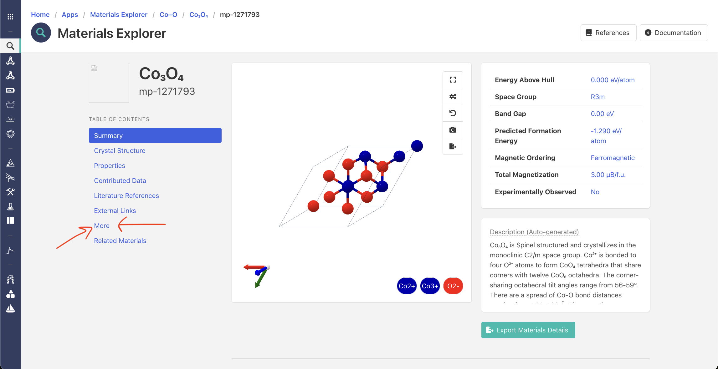

Thanks for confirming the website uses API data.
So, the website likely converts the API structure to a standard format.
After conversion, atomic positions and cell parameters are very similar (differing from the 4th decimal place), but oxidation states differ.
For example, the website assigns Co2+ to 0.6291685 0.0 0.8835005, while the API assigns Co3+ to 0.6291255 0.0 0.8834999. This likely stems from BVAnalyzer prediction differences.
Therefore, how does the web calculate and add these oxidation states? Is there any good option to assign oxidation states to API POSCAR file same as website POSCAR?

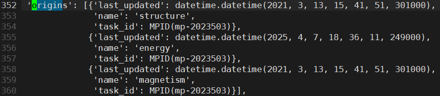

And, I’m sorry for asking the same thing multiple times, but ultimately, the source of the structure provided on the website is, as long as I look at the structure from the task ID found through the provenance command, that’s correct, right?
352 ā€˜origins’: [{ā€˜last_updated’: datetime.datetime(2021, 3, 13, 15, 41, 51, 301000),
353 ā€˜name’: ā€˜structure’,
354 ā€˜task_id’: MPID(mp-2023503)},
355 {ā€˜last_updated’: datetime.datetime(2025, 4, 7, 18, 36, 11, 249000),
356 ā€˜name’: ā€˜energy’,
357 ā€˜task_id’: MPID(mp-2023503)},
358 {ā€˜last_updated’: datetime.datetime(2021, 3, 13, 15, 41, 51, 301000),
359 ā€˜name’: ā€˜magnetism’,
360 ā€˜task_id’: MPID(mp-2023503)}],
361 ā€˜possible_species’: [ā€˜Ge2-’, ā€˜Co2+’],
Taking the file above as an example, mp-2023503, which was uploaded in 2021, is the API structure data.
Besides the data above, there’s also data listing various task IDs called task_ids, but this seems like just a record, right? There’s no detailed explanation for these IDs.
I’m wondering how I can obtain the exact same input (POSCAR, INCAR, KPOINTS, etc.) as what’s being provided on the web.

Please let me know if there is any documentation on viewing data related to a specific task_id, or documentation on how to read provenance data.

pprint(summary_doc.model_dump(), stream=file)
>  'origins': [{'last_updated': datetime.datetime(2021, 3, 13, 15, 41, 51, 301000),
>               'name': 'structure',
>               'task_id': MPID(mp-2023503)},
>              {'last_updated': datetime.datetime(2025, 4, 7, 18, 36, 11, 249000),
>               'name': 'energy',
>               'name': 'magnetism',
>               'task_id': MPID(mp-2023503)}],
The website uses the API and the mp_api client to retrieve data. However, skimming through the web code, the structure is retrieved from the API and then to_conventional is called on the structure. That’s why the interactive crystal diagram gives you the conventional cell on download
My apologies for the confusion there. I would recommend using the mp_api client directly to retrieve data if you want more control over the structure you get back from the API

  • I can’t find the calculation tab on the web. Where is ā€œMoreā€ tab?

Or again on the website by going to the More --> Calculations tabs:
If you don’t see a GGA Structure Optimization calculation listed there, you’ll have to perform your own. See this answer for a bit more information

    in that file, you can see that last_updated is split into two days: 2025-09-21 and 2021-03-13.
    The completed_at date is 2020-11-04.
The origin (from structure summary) has only 3 items: structure, energy, and magnetism.
There is missing electronic properties, DOS and band structure, so can you please tell me where was GGA for those calculations confirmed?
I also switching into electronic_structure and returns no output about origins.
This seems my data pulling mechanism is wrong. (I’m now trying to find how to use this endpoint…)
