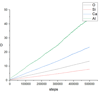

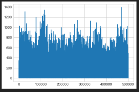

I am trying to compute diffusion coefficient of atoms in a specific sphere by compute chunk/msd, but the results seemed unreasonable. I plotted the msd versus steps in each spheres, but the plots show no relationship between msd and timestep (Figure 1). However, I tried compute msd without sphere, a linear relationship can be seen (Figure 2). I would like to know that did I make some mistakes in using compute msd/chunk? Thank you very much for replying.
