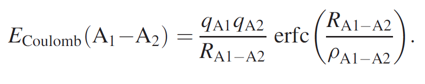

Thank you very much for your response. I have one question,how can I use one term of Wolf summation? if I can’t , so how can I import this potential which is in attached file?
I was very thanksful you are considering my problem
No. It would not work anyway, because your potential function is different.
This function is useless in this form without knowing what the individual parameters mean and - ideally - what publication this is taken from. I can guess most of them, but not all.
At any rate, this function looks different than anything implemented in LAMMPS and unless it can be transformed into any of those, you would have to implement a new pair style in C++ to be able to use it.
I try my best, many thanks for your answer
q is an effective charge, R is a bond distance, and ρ is the
screening factor
How is this screening factor determined? It looks like this may be different for each pair of particles or is it depending on the charge? or on the particle type and thus an input parameter?
What kind of particles does this represent? What kind of model is this? Are there publications?
The screening factor ρ(A1-A2)=(rA1+rA2)f is assumed to equal the sum of the covalent radii rAi of the two ions involved times a factor f that depends on the average absolute cation electronegativity and the average cation charge in the compound.
I try to calculate the diffusion coefficient of Na in NaZr2P3O12 7 Li in LiZr2P3O12 (NASICON materials)
Ok, thanks.
That means that if you want to use this kind of potential you need to implement a new pair style in C++.
https://docs.lammps.org/Modify.html
