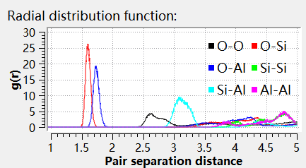

I have encountered a question regarding the partial radial distribution functions (RDFs) computed using OVITO.
My molecular dynamics model contains three atom types: O, Si, and Al. When I compute the partial RDFs in OVITO, it outputs the following pairs: O–O, O–Si, O–Al, Si–Si, Si–Al, and Al–Al (as shown in the attached figure).
However, I would like to obtain the RDFs with Si or Al as the central atom, specifically the Si–O and Al–O RDFs. Is there a way to specify the center atom type in OVITO to reverse the pair direction?

I am sorry if I have misunderstood your question. But I would say that the order of the two involved elements does not matter in a partial RDF. It’s symmetric.
The RDF for the pair Si-O is identical to the one for O-SI. The radial distances between Si and O atoms are statistically distributed in the same way as the distances between O and Si atoms.
This is also what the OVITO documentation says: g_{⍺β}(r) \equiv g_{β⍺}(r) for any pair of atom types ⍺ and β. That’s why OVITO outputs only one of the two.

I agure that gAB should not idential gBA, when calculating the coordination number. The atom concentration should be considered?
Right, g_{\alpha\beta}(r) has been normalized by the atom counts of species \alpha and of species \beta. It’s basically a histogram of the distances between all \alpha atoms and all \beta atoms, divided by the product of atom counts, N_\alpha * N_\beta, and the volume of the spherical shells at each r.
Depending on what you want to compute, you may have to multiply g_{\alpha\beta}(r) with just a single concentration (or absolute atom count), and then the symmetry between \alpha and \beta gets broken.
