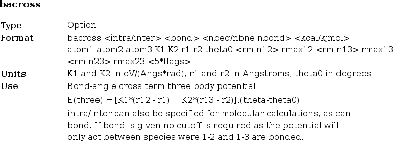

I attach the GULP doc for specific terms, hoping it helps you understand the way GULP defines force field.
bond cross term
bond angle cross term
angle cross term
