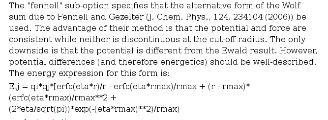

thanks for the reply of steve, but i think i really got problem with electrostatic energy. follow you comment in the last email, i did single point calculation in both GULP and lammps with the same molecular configuration using only electrostatic potential. i use “coul/dsf” in lammps (in GULP, it is called “qwolf fennel”). the two parameter eta =0.01, cutoff = 12.0 in both codes. the “qwolf fennel” in GULP is defined as follows:
which is the same as is define in lammps coul/dsf. But here is the output from the two codes

GULP
Lattice summation method = Wolf et alModified method - smooth cut-off / consistent forces (Fennell-Gezelter)
Eta = 0.010000 Angstrom**-1
Cutoff = 12.000000 Angstrom
