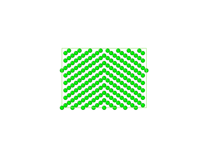

I built a LLZO grain boundary model using Atomsk. Because there were overlapping atoms at the GB region, I used the remove doubles command in Atomsk to delete atoms that were too close. After this removal, the stoichiometry of the system is no longer conserved, and the net charge becomes non-zero.The picture is Zr of my model.
