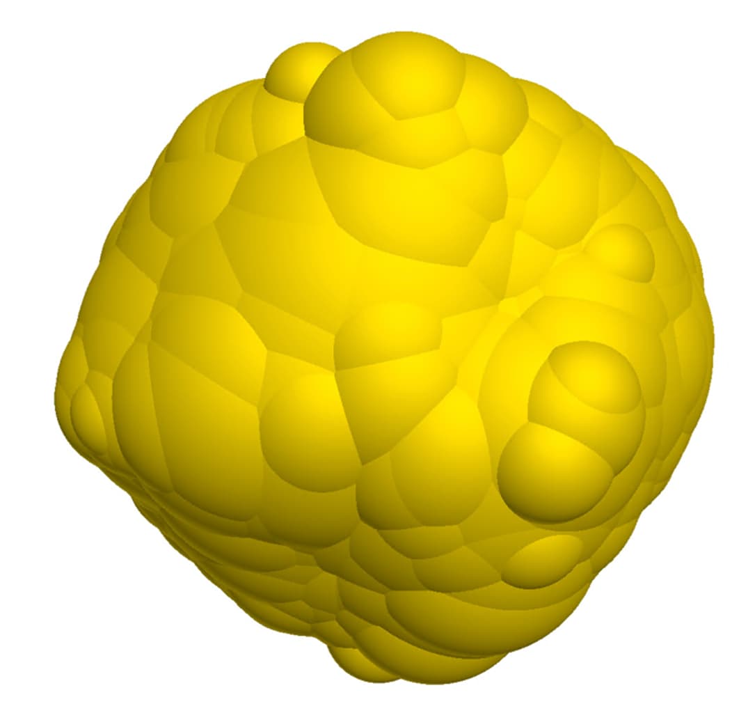

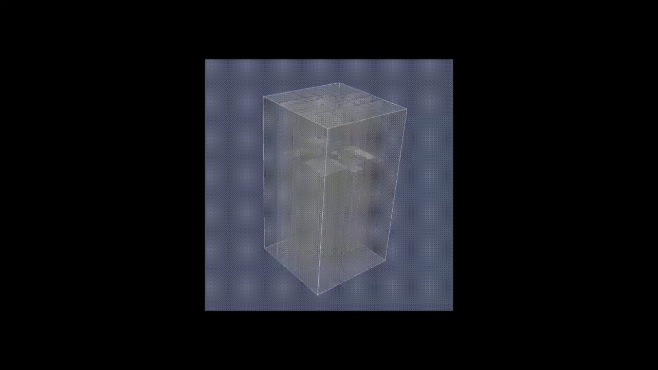

I’ve attached the input script and a short animation of the simulation to help illustrate the clump setup.
