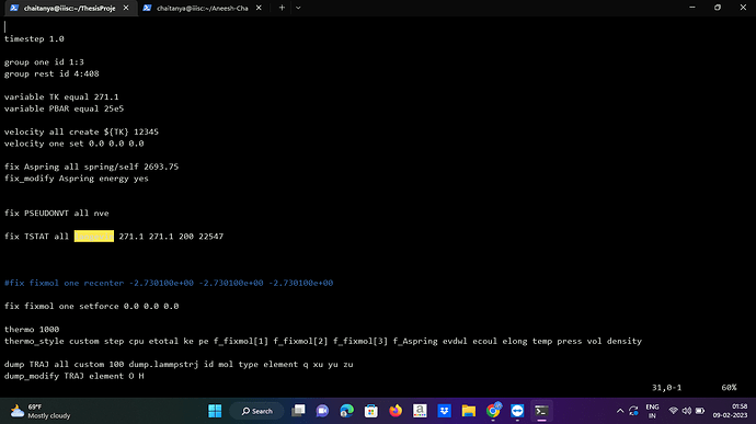

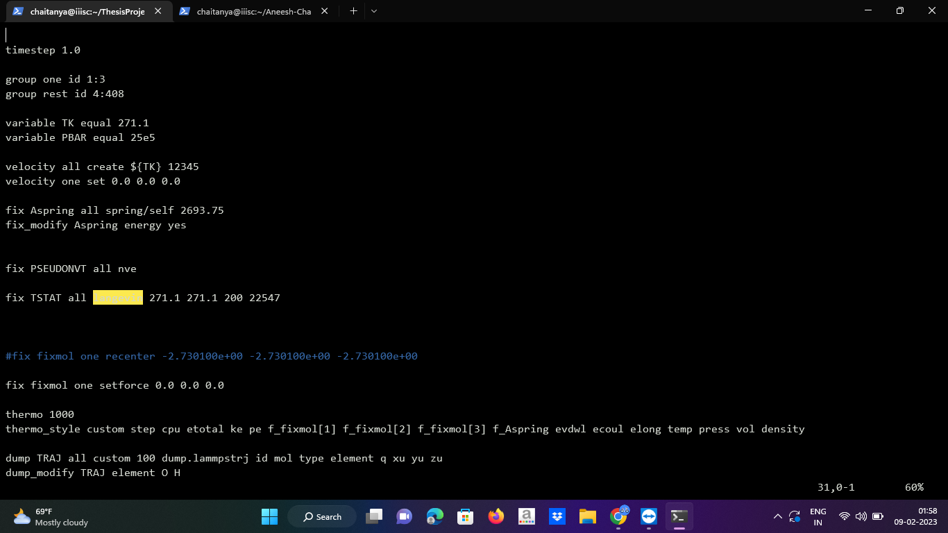

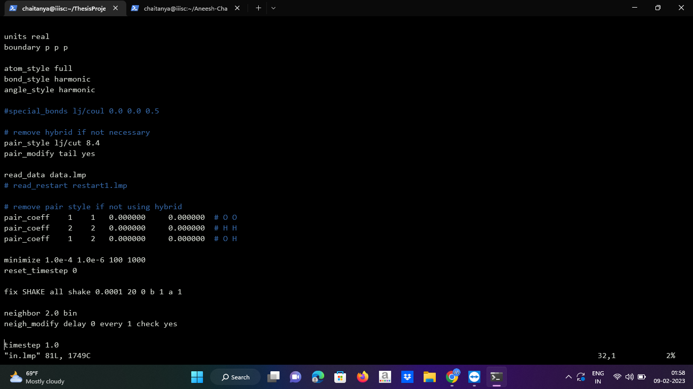

I am attaching my input file screenshots.

Uploading screenshots is a waste of bandwidth and is making it a much bigger effort to check out your input compared to attaching the file
in.melt (736 Bytes)
or inserting the text as quoted text (using triple backquotes (```)) as shown below for the “melt example”. One cannot easily cut-n-paste text from images.
If you want the best help, you need to make it easy to help you. The more effort it is to read and test what you are doing, the less likely is it that people will respond (and that is an exponential or worse relation).

Sorry for the inconvenience. I am attaching the unit file as text.
atom_style full
bond_style harmonic
angle_style harmonic
pair_style lj/cut 8.4
pair_modify tail yes
read_data data.lmp
pair_coeff    1    1   0.000000     0.000000  # O O
pair_coeff    2    2   0.000000     0.000000  # H H
pair_coeff    1    2   0.000000     0.000000  # O H
minimize 1.0e-4 1.0e-6 100 1000
reset_timestep 0
fix SHAKE all shake 0.0001 20 0 b 1 a 1
neighbor 2.0 bin
neigh_modify delay 0 every 1 check yes
timestep 0.8
group one id 1:3
group rest id 4:408
variable TK equal 271.1
variable PBAR equal 25e5
velocity all create ${TK} 12345
velocity one set 0.0 0.0 0.0
fix Aspring all spring/self 2693.75
fix_modify Aspring energy yes
fix PSEUDONVT all nve
fix TSTAT all langevin 271.1 271.1 200 22547
fix fixmol one setforce 0.0 0.0 0.0
thermo 1000
thermo_style custom step cpu etotal ke pe f_fixmol[1] f_fixmol[2] f_fixmol[3] f_Aspring evdwl ecoul elong temp press vol density
dump TRAJ all custom 100 dump.lammpstrj id mol type element q xu yu zu
dump_modify TRAJ element O H
restart 100000 restart*.delta_A1
run 1250000
write_data data_delta_A1.eq.lmp
