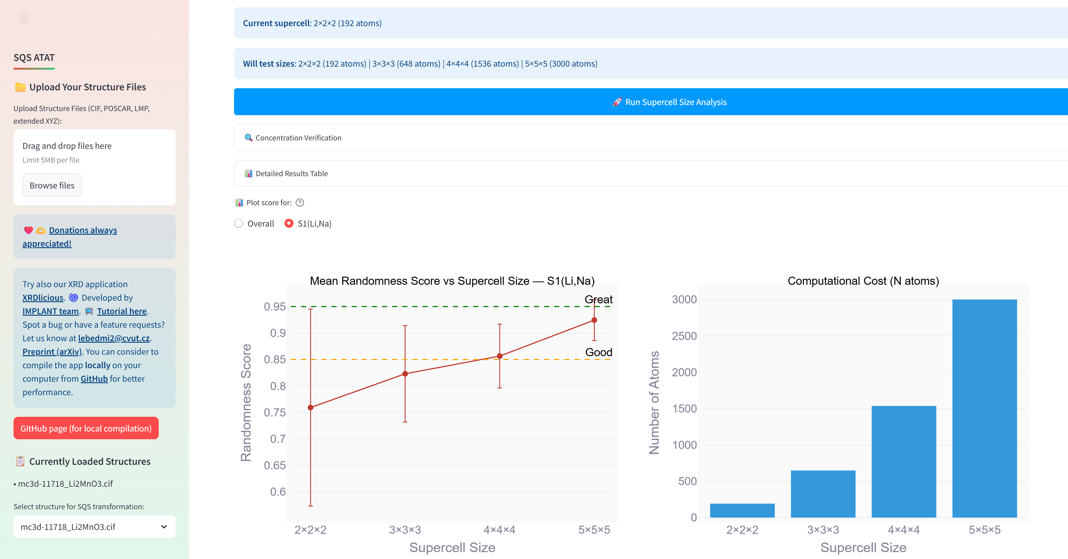

Supercell size depends on your system. For instance (see the figure below), If I use Li2MnO3 and replace Li with 75 % of Na, then if I perform analysis of randomness score based on WC vs. supercell size, I see that up to 4x4x4, it is better to use the mcsqs search to generate reasonable random structure model rather than simply generate the structure completely randomly (placing the atoms randomly on their position).
