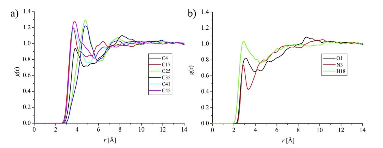

While reading papers related to RDF, came across this graph.
The authors have plotted RDF for each and every atom of their organic compound
using schrodinger materials science suite.
What would be the corresponding command in Lammps?

Thank you for the reply.
I am able to get RDF at longer distances.
compound
you need to assign a different atom type to each atom in the compound.
compute rdf discriminates atoms by atom type.
