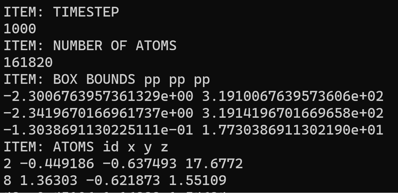

I have a file: avg-1000.dump, at timestep 1000, and need to read in the atom positions.
The file is like this, with data columns of id x y z:
I tried using the read_dump command to read in the atom positions, but it’s not working:

If you are using the “add yes” flag, you tell LAMMPS to create new atoms, but that is not possible without setting an atom type. But your dump file only contains the atom ID and the positions, so read_dump has to error out and report that a field is missing (i.e. the “type” field).
I’m using the most recent version of LAMMPS. Adding the atom type to the dump file makes it work. Thank you!
