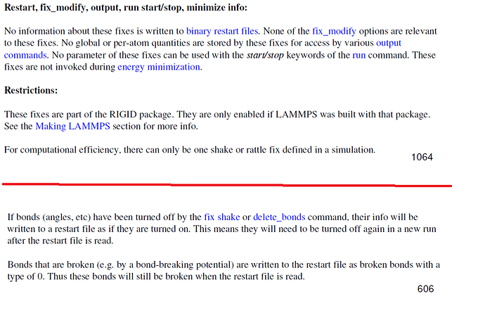

After using read-restart ,in order to computing MSD, Is it necessary turn off the minimization and fix shake? I compared turn on and turn off and I find that the results are different. which one is correct?

I saw page 1064 (2017 manual) which is different of page 606!!
do the shake info save in restart-file, and shake must be turn off after restart file?
or shake must be on after restart file?

Manual on the LAMMPS website write the same things as manual.I checked.
there is no conflict. fix shake does indeed not store any information into the restart. so the first statement is correct.
also, if you are using fix shake, bonds are labeled internally to be inactive, since fix shake will enforce their length and computing forces would be redundant. however, when storing the state of the system, it is done as if fix shake was deleted, which is not in conflict with the first statement
neither.
you must redefine any fix after restarting.
