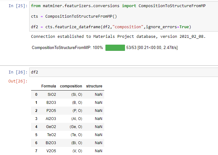

For example, i have the compositions in my dataset. But when i use CompositionToStructureFromMP () to convert it into structures, i get only NaN. I dont get the new feature. Kindly help.

I have created my own dataset (of binary nitrides) with the compositions taken from the Materials Project database. That should be fine right? I believe we can load our own datasets and work, and it need not always be imported from matminer? But I still get NaN for simple compounds like SiO2 and Al2O3. Please find attached a snapshot of the same.
"MPRestError: REST query returned with error status code 403. Content: b’{“valid_response”: false, “error”: “API_KEY is not supplied.”, “version”: {“db”: “2021_02_08”, “pymatgen”: “2021.2.8.1”, “rest”: “2.0”}, “created_at”: “2021-03-02T17:58:24.373420”}’
TO SKIP THESE ERRORS when featurizing specific compounds, set ‘ignore_errors=True’ when running the batch featurize() operation (e.g., featurize_many(), featurize_dataframe(), etc.). "
