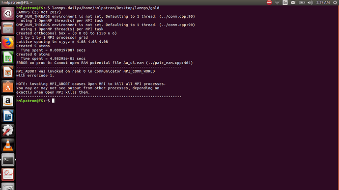

i took the advises given for my code. i have changed the units to metal. now i am just trying to simulate gold particles at the start and end of my channel. i am getting the following error. for some reason th eam file is not detected can anyone help me with the error.
below is the reference and error
this the code

Well, did you put the potential file where LAMMPS looks for it?
Yes, I did.
Yes, I did.
​prove it!​
​what i see in your screenshot tells a different story.
axel.​
i have placed th eam file where i have saved the code
it still gives me the same error.
yes, because all paths are considered relative to the working directory of the executable unless they start with a / and then have to be a full path.
in your first screenshot you were launching LAMMPS in your home directory, and that is not where you put your input or the potential file.
now, when launching LAMMPS, you did pass the relative path to the input file, but inside the input file, there is no path, so LAMMPS will try too find the EAM file in the current folder (or in the folder pointed to by the LAMMPS_POTENTIALS environment variable).
anyway, it is considered good practice to launch LAMMPS in the same folder, where you place your input deck. if you do this, the error message will magically go away.
