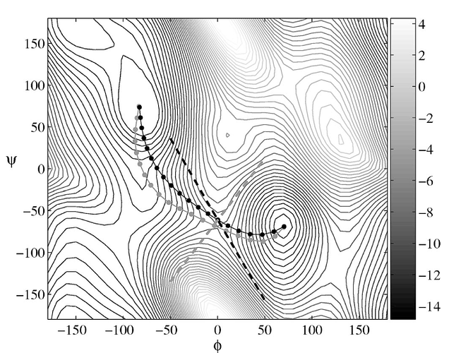

I see that as NEB runs go on, the phi, psi values for my first and last replicas change a lot from their starting values, which they shouldn’t, as they are already close to the minima. I also observe that the minimum energy curve I obtain (by plotting phi, psi values of replicas, attached image adp_neb.png, after 50, 100, 500 and 1000 neb steps) is very different from what is available in research papers (attached image mep.png, taken from String method in collective variables: Minimum free energy paths and isocommittor surfaces; Luca Maragliano, Alexander Fischer, and Eric Vanden-Eijnden, 2006). I have attached my input file in this mail as well.
