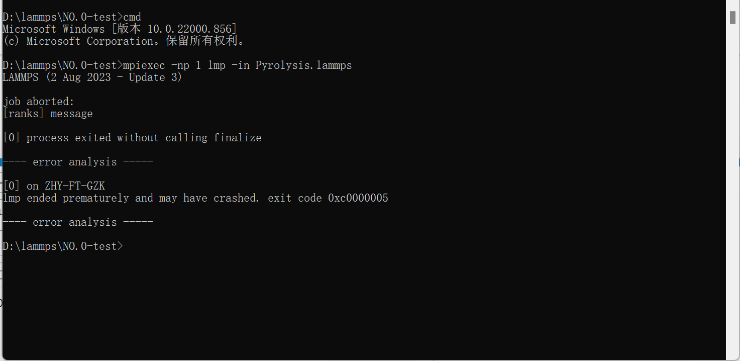

Dear Lammps Users,as the picture when i running lammps , the “job aborted” prompt appears, I don’t know how to modify or which files should be checked out to solve this problem, I hope to get your help! thanks!
Likely there is an error in your Pyrolysis.lammps input file.
The actual LAMMPS error message seems to be hidden due to Windows/MPI buffering of standard output. You can try adding the flags -echo screen -nb to your command line to have more detailed logging to the screen and to turn of buffering.
