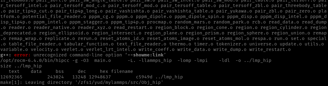

Hi, I am a beginner at using LAMMPS, so please bared with me. I am currently running Ubuntu 24.02 server with AMD CPU (9654) with AMD GPU (MI210). I am using the stable branch off the github as of (25 Jun 2025). Below are the steps that I have done with screenshots. I have checked out the forum on here for the MI200 install from 2 years again but it did not help me to guide through this issue. Please and thank.

Then a make hip -j$(nproc)
But I would keep getting this issue:
I was able to get the CPU build working with hip version and the oneapi.
@DigitalYD you need to use a Kokkos Makefile which enables the HIP backend, for example see: lammps/src/MAKE/MACHINES/Makefile.frontier_kokkos at b7be53f3fcfdcc25f3e62a06d1fe624d4b20134c · lammps/lammps · GitHub.

That is for the GPU package, not KOKKOS.

LAMMPS has two packages that support GPUs. One is called (quite confusingly) the “GPU” package, and the other is KOKKOS. They are different. So makefiles for the “GPU” package won’t work for the KOKKOS package. See 7.4. Accelerator packages — LAMMPS documentation for more info.
