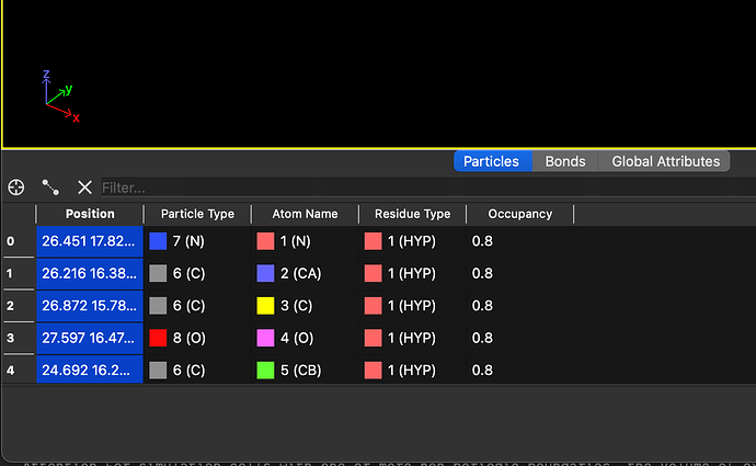

Once you have selected the atoms its easiest to use the Invert selection followed by the Delete selected modifiers to only retain the surface atoms in the scene. Afterwards you can use any of the OVITO file exporters to export the coordinates of the surface atoms to a file.
Alternatively you can copy and paste the coordinates straight from the data inspector:
