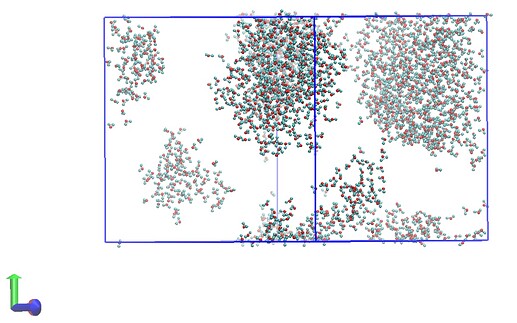

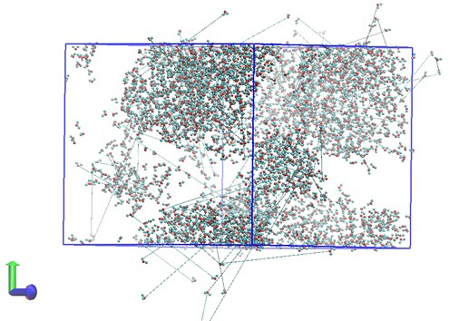

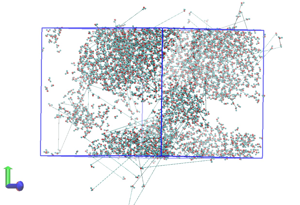

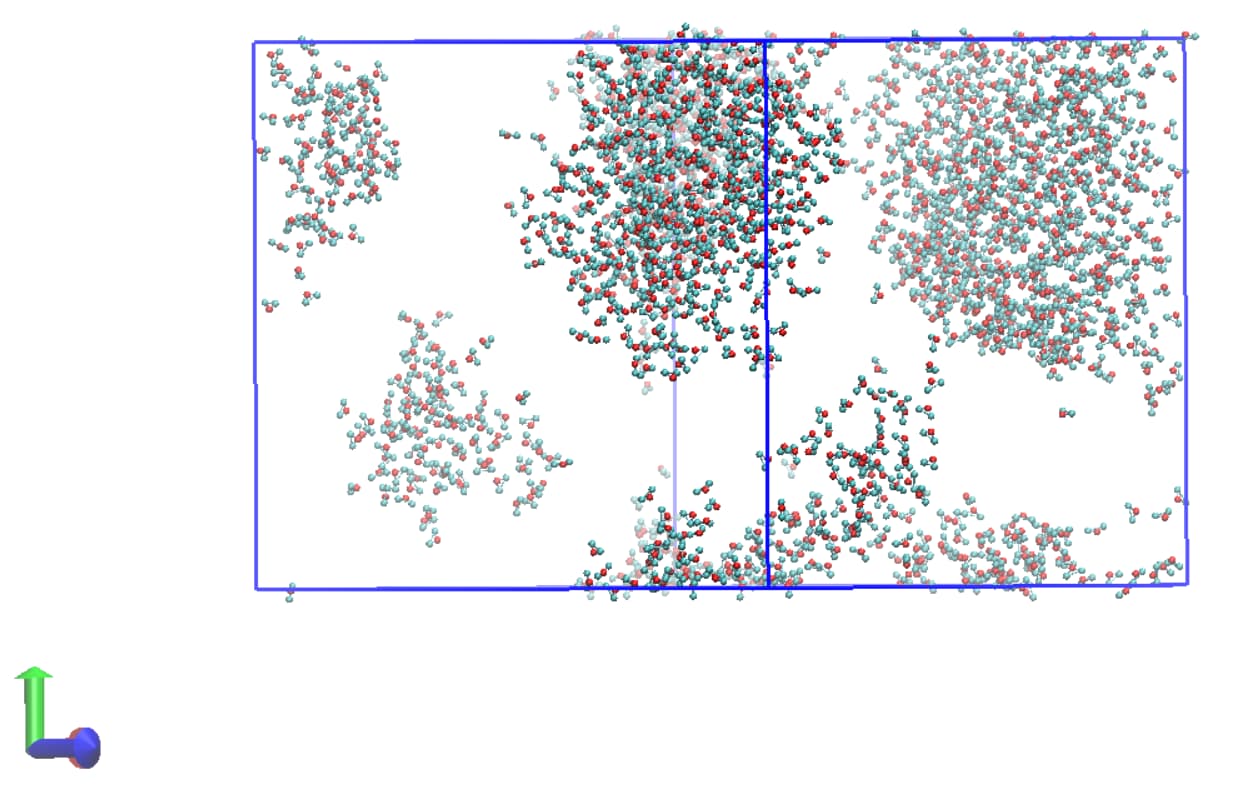

I have included two snapshots of the simulation box (each from a trajectory file) below. The first is of the system before additional waters are inserted and the second is after. Both have been wrapped by residue/molecule and I am just showing water molecules for clarity here.
It’s clear that there is some issue with incorrect image flags for atoms water molecules at the periodic boundary leading to the appearance of bonding between different molecules when the trajectory is visualised. It’s worth noting that VMD reads the bonding for the trajectory files incorrectly (assigning a bond between water hydrogens for example) and that the topology file itself shows the correct bonding.

The “incorrect” bonding would happen only when you load the trajectory without loading the data file first. The trajectory dump does not contain any bonding information and VMD’s heuristics are limited. When loading the data file first and then the trajectory dump on top of that, you should retain the correct bonding (unless you have incorrectly wrapped positions or inconsistent image flags).
