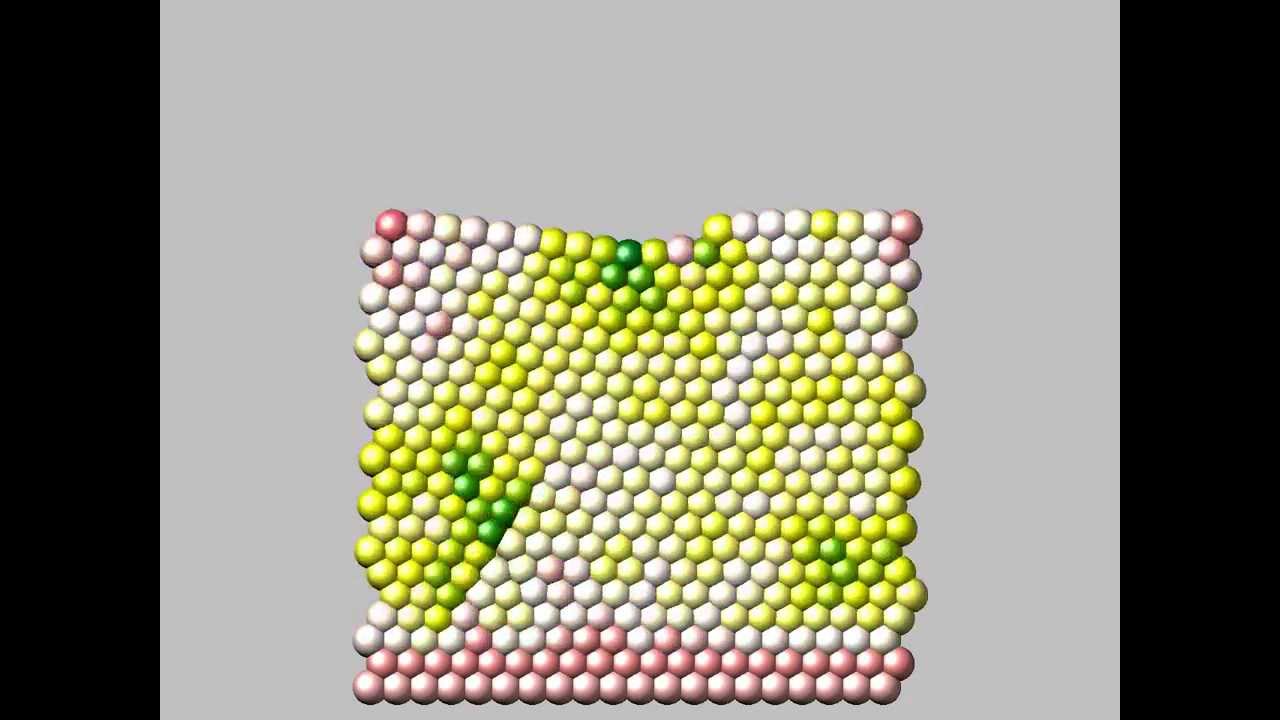

Please see this animation of the “indent” example from the LAMMPS examples tree.
