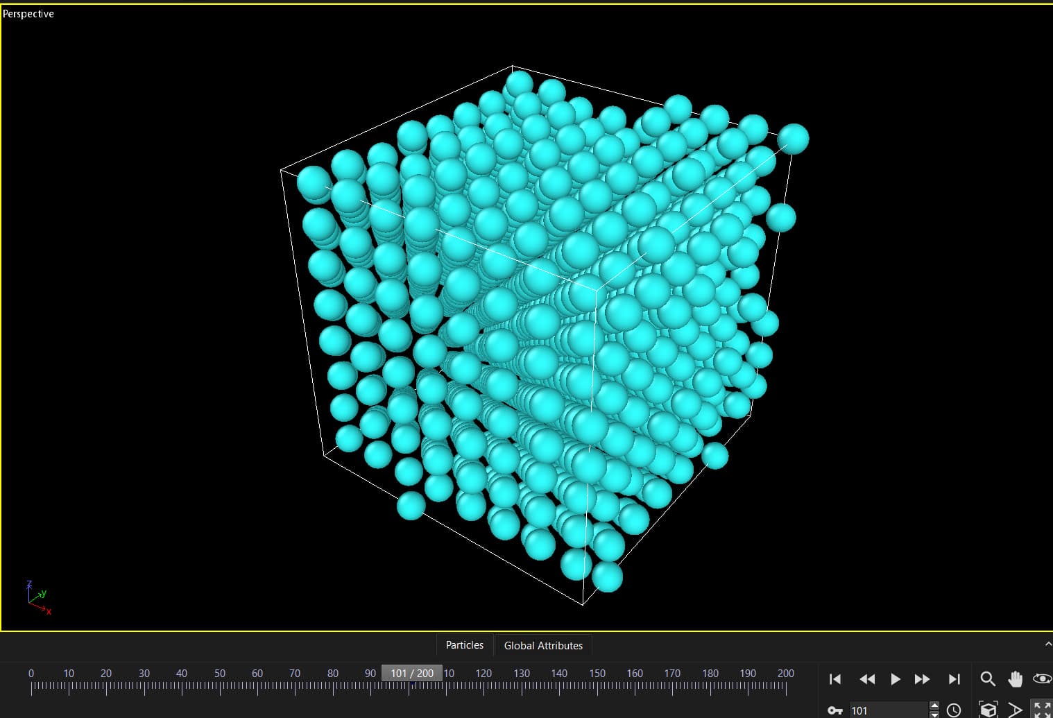

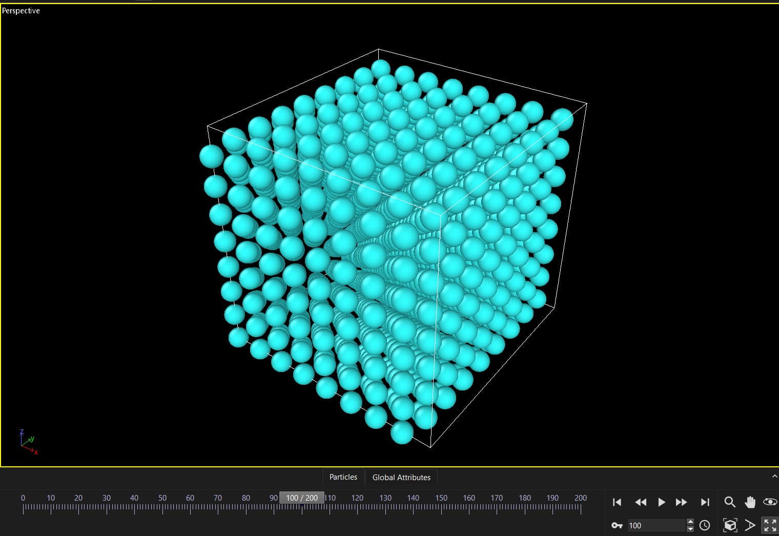

The simulation at step 100
The simulation at step 101

Some of your atoms are very close to the box periodic boundaries, so tiny fluctuations are enough to move the atoms from one side of the box to the other. I see nothing wrong here, this not a “deformation”, just a visual effect.

I’m expecting some movement due to temperature, the issue is that it’s not smooth. From timesteps 1-100 atoms move slow, from 100-101 there is a big change in the positions. I don’t think this can be attributed to temperature because it’s not smooth, but rather something related to two consecutive runs.
Your thinking is wrong. The situation is as @simongravelle describes it. If this is more visible at the beginning of a run, then this is because that usually enforces a neighbor list rebuild and that will update atoms according to the periodic boundary conditions, which may mean to move them across the box and change their image flags. This happens particularly often when you are using an unshifted lattice and box boundaries on multiples of the lattice spacing, since then a lot of atom positions are exactly on the box boundaries and already the tiniest motion can move them out of the box. For efficiency reasons, LAMMPS does not enforce this, but atoms are allowed to move outside the box for a little bit until the next reneighboring.
You can enforce dump output remapped exactly to PBCs with dump_modify pbc yes (at extra communication and compute effort).
