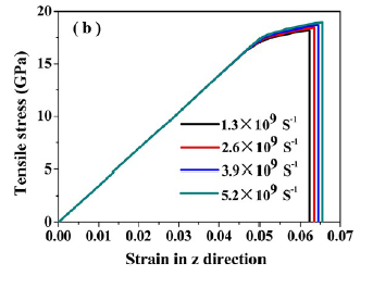

I got your point and my apology for failing to elaborate appropriately on the problem. For potential, I used tersoff potential which was calibrated by Brito Mota. For the initial configuration, I downloaded the .Cif file of Beta silicon nitride from crystallography.net and also I built it using the space group and then I replicated it to obtain a thin layer ( ending in the same results for both cases ). For stress, I used virial and for strain, it is engineering strain. I attached my files ( Si3N4. in as my initial configuration and Input.in as my input command SiN as the parameters of tersoff potential). I also, attach the diagram I expect to get based on a published paper [1]. But, anyway the answer I get is not correct as I obtain a high value of fracture stress and even strain. I will deeply appreciate your help within any comment. Honestly, this is the problem that I’m working on it for a month. But, unfortunately I couldn’t solve it and I really think that to the best of my knowledge I’m doing the simulation correctly.
