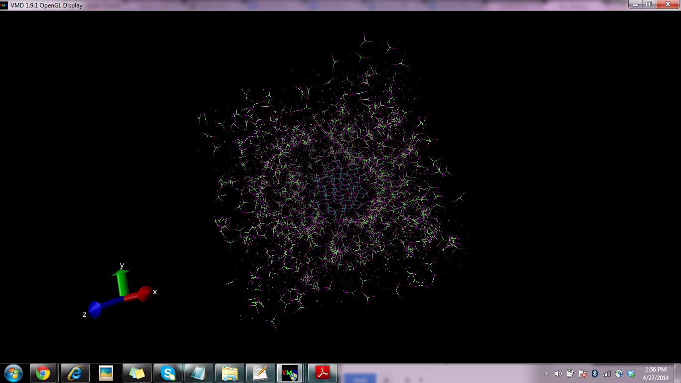

Hello all,
I am attaching two images. One show’s the SiO2 cluster I am trying to make. and the other is the entire simulation box along with the cluster at the center. Its a amorphous alpha crystal of SiO2.

For starters, why in the world would you keep record of all previous posting with issues completely alien to yours instead of just focusing on the one that concerns you?
As to making the nano-cluster, why not using the BKS potential for SiO2 so that you don’t have to worry about bonded and angular terms in the FF? The BKS potential has been tested quite a bit in the quartz system. However, keep in mind that unless you know the initial cluster structure from Xtalography, a few steps may be required to create the initial cluster shape (some annealing of the bulk lattice or some PES search to identify low-energy cluster configurations). The last comment applies to any FF you decide to use when modeling the cluster geometry.
