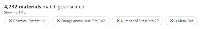

I’m writing this post to ask a simple question as I’ve encountered an issue while working on my paper.
First, I’m currently using mp-api version 0.42.1.
With this version, I’ve completed the entire process of sorting existing data (with desired conditions such as band gap, hull E, etc.) and creating inputs for the necessary materials.
However, it seems the version has been updated, and the number of materials displayed on the Materials Project website differs from the number of materials I extracted at that time (I believe I extracted them about a year ago).
For my paper, I need to document the number of materials at each sorting stage, but I’m facing an issue where I cannot see the intermediate stages because the material count has changed.
My initial solution was to extract materials at each stage using mp-api version 0.42.1, but the existing code doesn’t work due to version differences.
If you have any good solutions, I would appreciate your response.

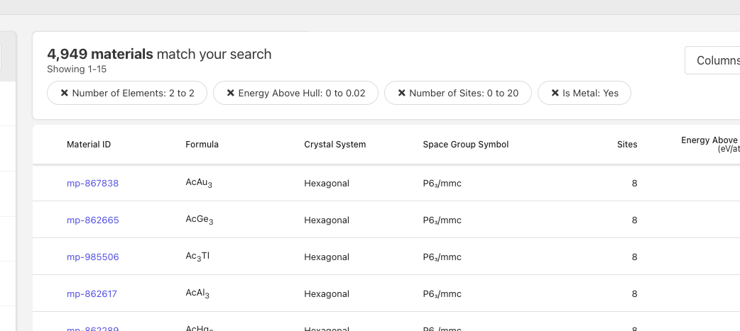

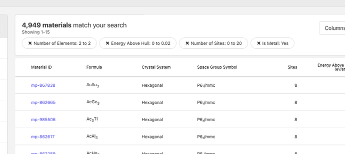

would return:
(pipelines) ~/tmp > python test.py
Num Feb metallic mats: 4770
Num April metallic mats: 4940
and if you compare that with whats available in the current version it’s gone up since last year (via the website):
So you could repeat the process with any of the database versions that are available in AWS.
I would recommend just trying out the database versions you think are relevant and make pandas dataframes and try to filter them as is useful to you. Everything I saw in your script file should be manageable using the dataframes (selecting the material_ids, formulas, etc.).

I don’t remember the exact date when I updated it, but when I last checked, it was 4,732.
Considering the number of data points in the information you provided, it’s likely that it’s data from before February, 2025.
