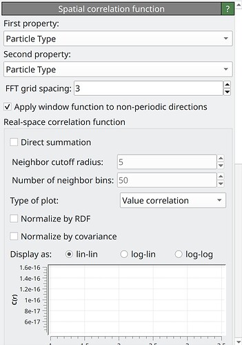

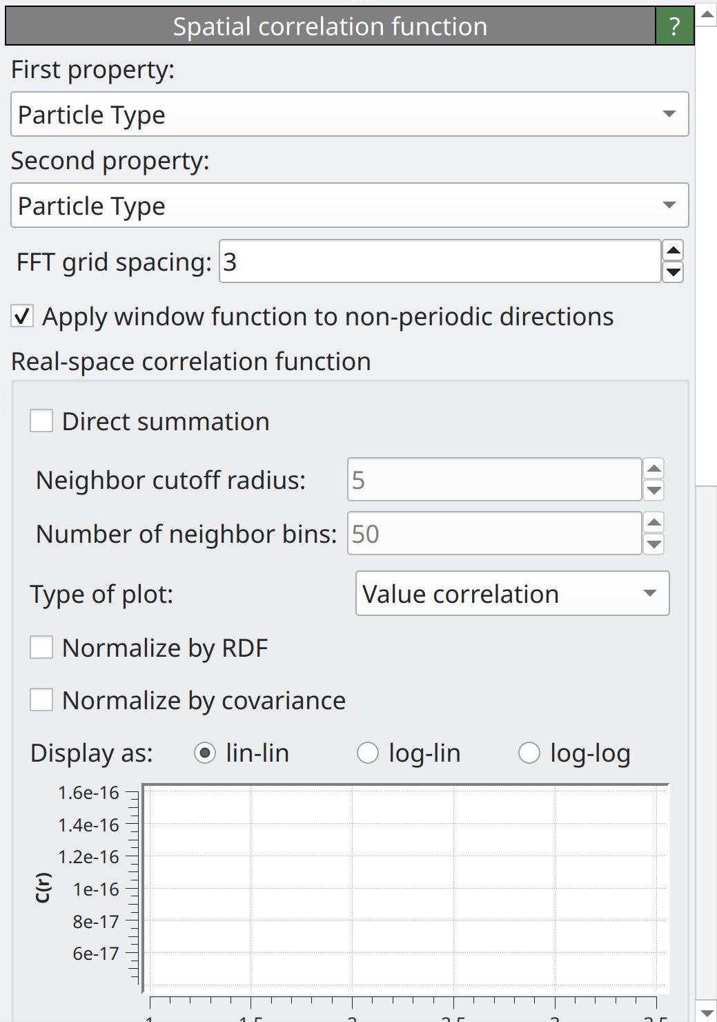

Unfortunately, I have not been able to reproduce the crash so far. I assume it also depends on the precise settings of the Spatial Correlation modifier. Can you tell me your settings or send me a .ovito state file? (The latter for the working POSCAR file, otherwise you cannot save the state file before the crash.) Thanks!

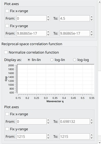

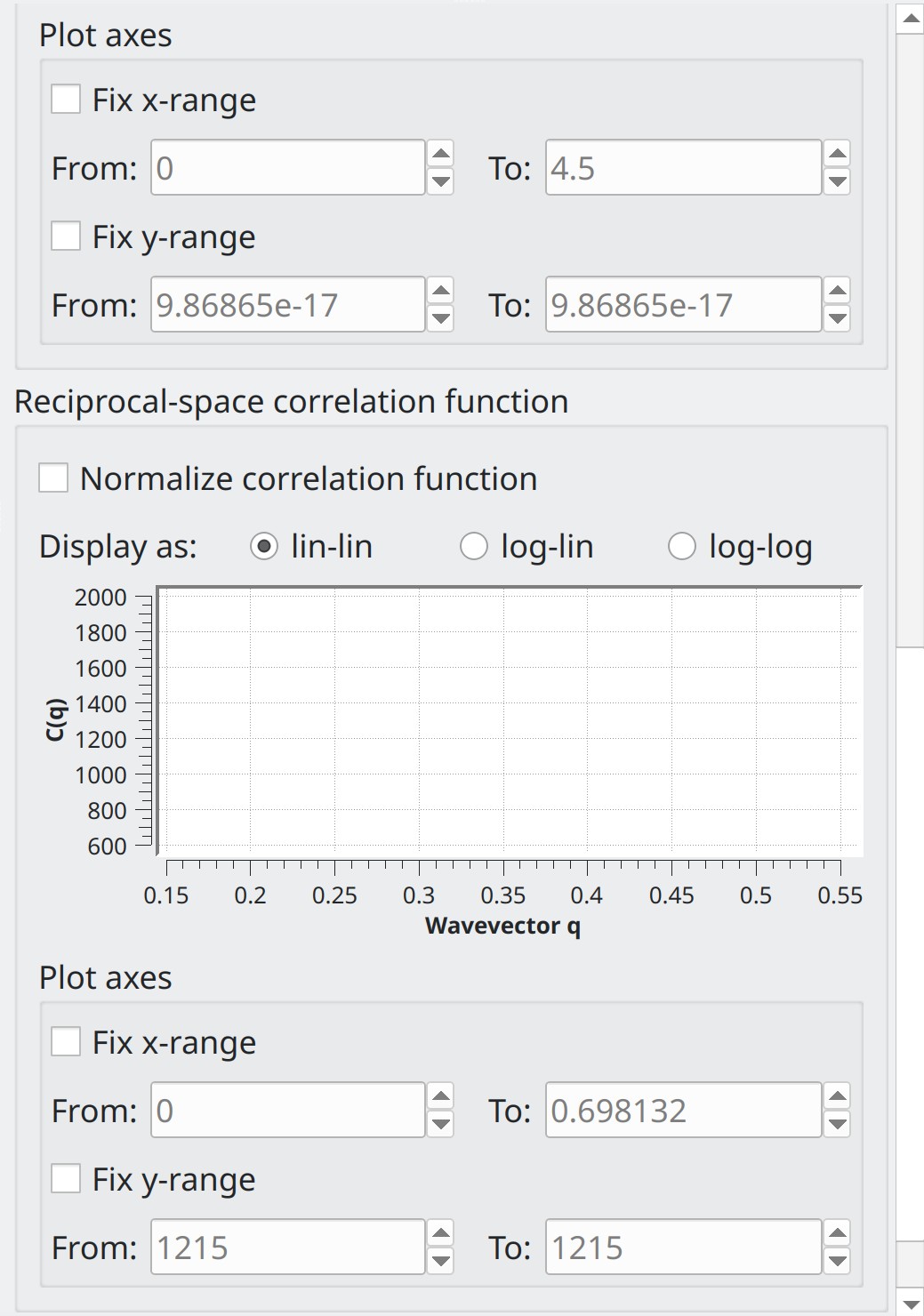

Hi, thanks for the response.
The settings are here (I added the modifier on the “good” input file and then took the screenshots):
I also tested it on an almost new installation (which I am quite sure that I never touched the settings of this modifier) and it also crashed.
