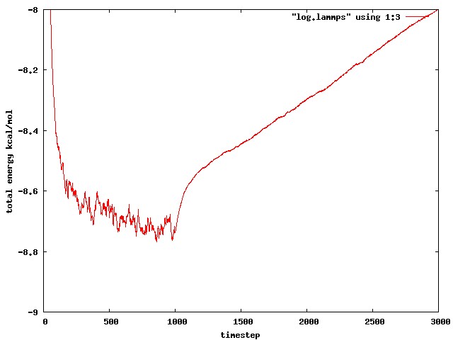

I’m sorry, I should have said in my initial email, I get a similar energy jump using dipole/cut. Its slightly harder to see because using the cut potential does not conserve the energy so well in the NVE portion of the simulation. I have run a short simulation (1000 steps NVT, followed by 1000 steps NVE) using dipole/cut. Hopefully you can see from the attached jpeg that the total energy increases very fast at the beginning of the NVE portion, much faster than the energy drift later in the NVE portion. I have also attached the input script for this dipole/cut simulation.

Hi Steve,
the issue here is not about the energy conservation generally - I agree that using a straight cutoff the total energy in an NVE run should steadily increase (as it does in this case).
The problem is that the energy shows an unexpected jump at the very beginning of the NVE run (step 1000 in the diagram attached by Sophia in her previous message), before settling on a steady increase.
Using the shifted-force version (where a better energy conservation is expected), the same issue shows up as an anomalous jump at the very beginning of the NVE run, which you can see in the first three lines of this portion of the log file that Sophia attached to her first message:

Why does the total energy initially increase before settling on a constant value (-7.27[…])? It should be fluctuating about a constant value from the very beginning.
In fact, if the dipoles are removed, this issue also disappears, i.e., the energy steadily increases using the cut potential (no jump), or immediately settles on a constant value using the sf potential.
