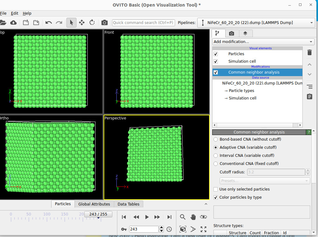

Stacking fault not created
I tried to write a code to create a stacking fault by displacement but after I visualize it doesn’t get created, could you help me with that? Thank you so much!
