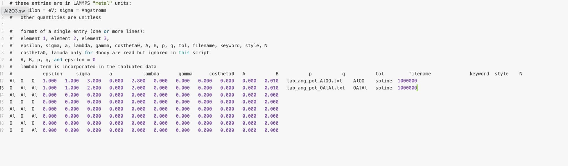

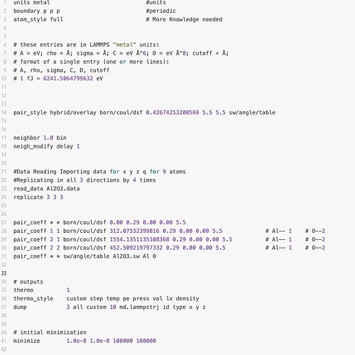

I am modelling Alumina using sw three body parameter and receiving error
ERROR: Unknown table style O of angle table file (src/src/MANYBODY/pair_sw_angle_table.cpp:301)
Last command: pair_coeff * * sw/angle/table Al2O3.sw Al O
Input File
Potential File

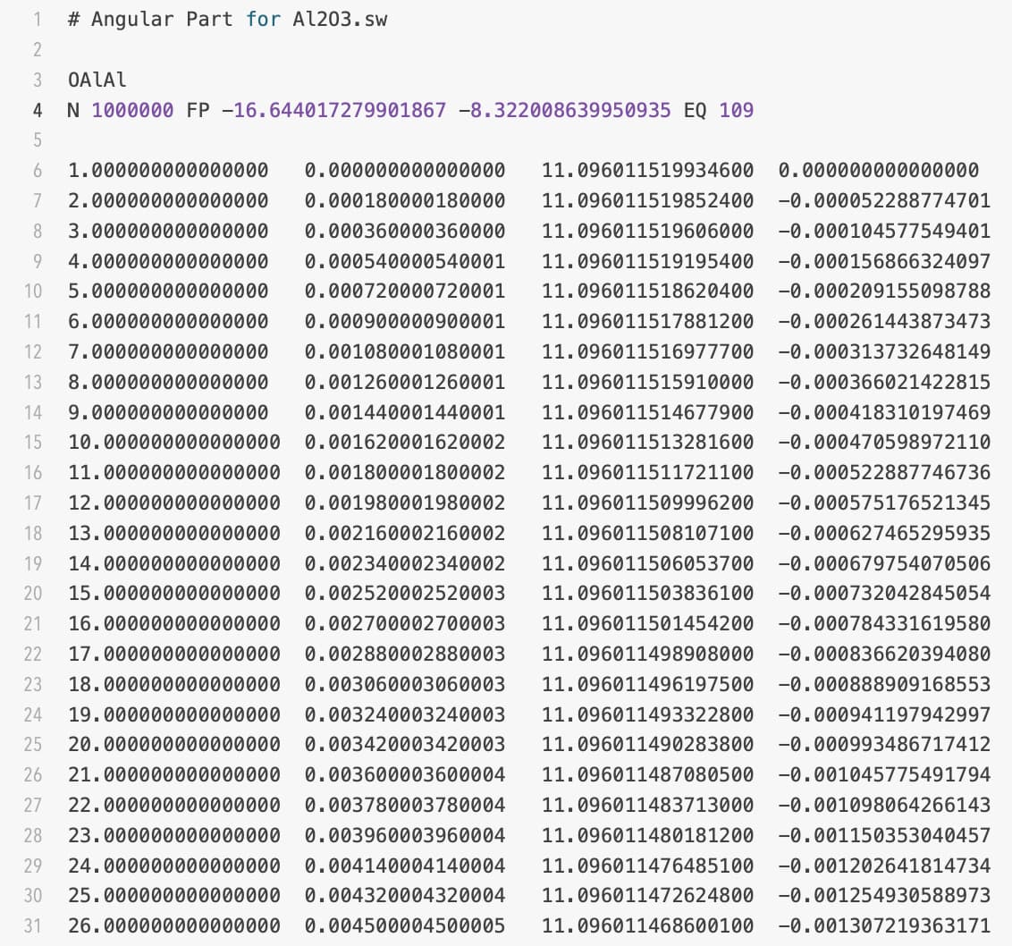

Angular Energy OAlAl

Your Al2O3.sw file is not correct. You have table files only for the first two entries, but the remaining 6 entries have “0 0 0 0” instead. Hence the error message.
Thank You that fixes the problem,

WARNING: 181 of 181 lines in table incomplete or could not be parsed (src/src/MANYBODY/pair_sw_angle_table.cpp:474)
ERROR: Angle table must range from 0 to 180 degrees (src/src/MANYBODY/pair_sw_angle_table.cpp:359)
I am following the manual template for angular energy table. Here I have attached the files also.

Also I only need AlOO and OAlAl three body parameters, therefore I added a keyword for the rest possible combinations but made values to be zero because of the previous error.
It was format problem, Needed a single space between all numbers, Solved Above problem

The error is raised because an illegal angle value (infinite or NaN) is passed to the lookup function when computing the forces.
So it is likely that either your configuration or your potential file is bad in some way.
Your geometry is bogus. Just sort the coordinate by x, y, or z and you’ll find that you have multiple atoms with nearly identical coordinates.
In fact, when I add the command “delete_atoms overlap 0.02 all all”, 104 atoms are deleted for being closer than 0.02 angstrom than another atom and only 56 remain. That is a very bad sign.
This is the good old GIGO principle at work.
Yeah Geometry was the problem. Thank you everyone for inputs. It’s running without error now.
